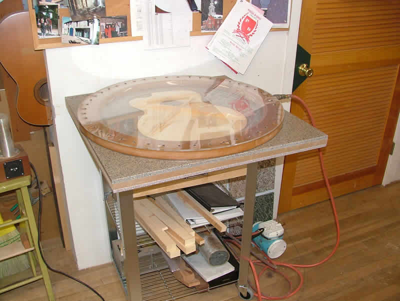

I'm going to be bracing up my next batch of 3 guitars shortly after the ASIA Symp. I'd like to use a vac clamp for them. I understand how you build the box to hold the rubber sheeting, but what do you do to the dish that the top/back lay in? Do I need to cut channels in the radii dishes, leave them unchanged?

Why not? The big issue is getting a good air-tight seal. That's the crucial element. If you had a frame that you placed down over a polished steel table, or a polished Corian table etc, it should work fine. I assumed that the dishes would work ok without the grooves, but that's the way I first saw it done, so I followed suit.Don Williams38516.4159722222

That is EXACTLY how Frank Finocchio does it.
His dish is corian, and the top plate simply lays on top of it. The vacuum part is made of MDF that has a few layers of finish on it.
One nice thing about his is that the membrain is clear so you can see if anything shifted and how much squeeze out you are getting. He just used part of an old vacuum bag.
I thought this was a really slick set up.

I'm working with several builders on building the base unit for this type of setup in the picture above. If you visit my website, you can see the radius dishes that I offer. It is basically the same dish, except with a backer piece of mdf, and it is square, and has the lip that you drop the top part of the vacuum piece onto it. Also, it is covered with a fiberglass resin that will allow you to have a smooth surface to clamp on just like corian. These are custom jobs, but we only charge a $25 extra fee per dish. As for the complete vacuum system, I'm still trying to get my partner to start offering these, but it is a little more involved.
